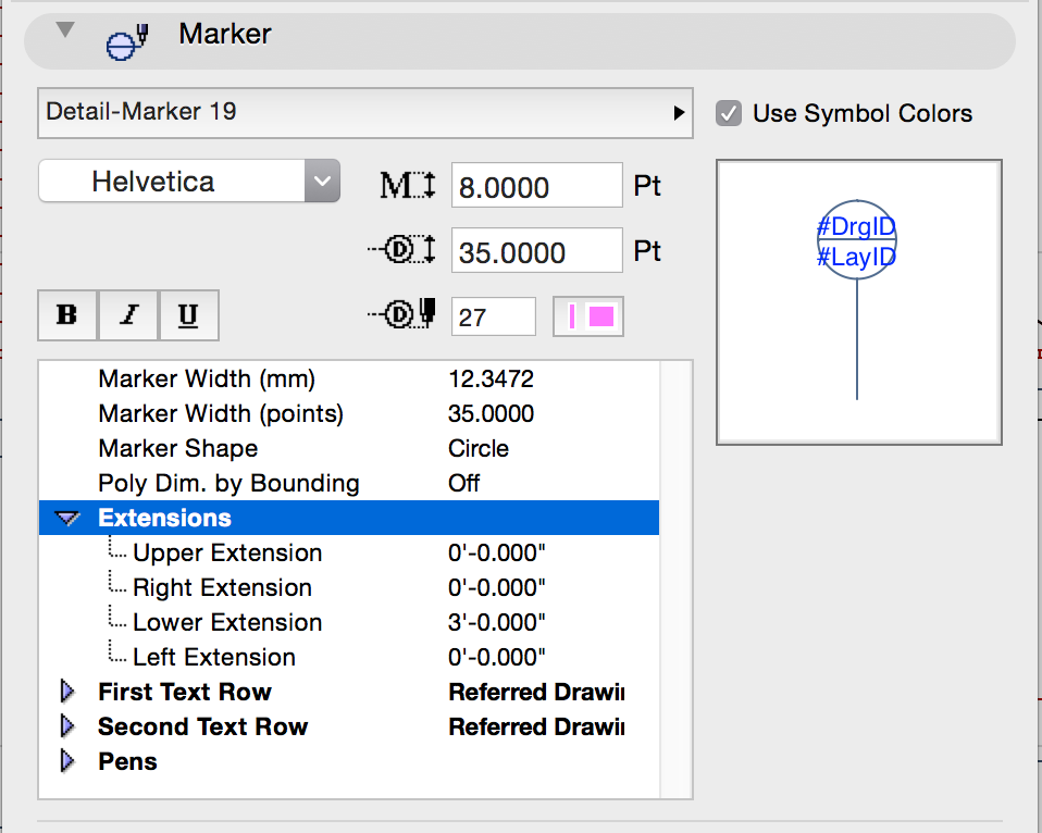

David Maudlin
Rockstar
Bobby Hollywood:
Try these settings for the Detail-Marker, there is no "bubble" with this marker.
David
