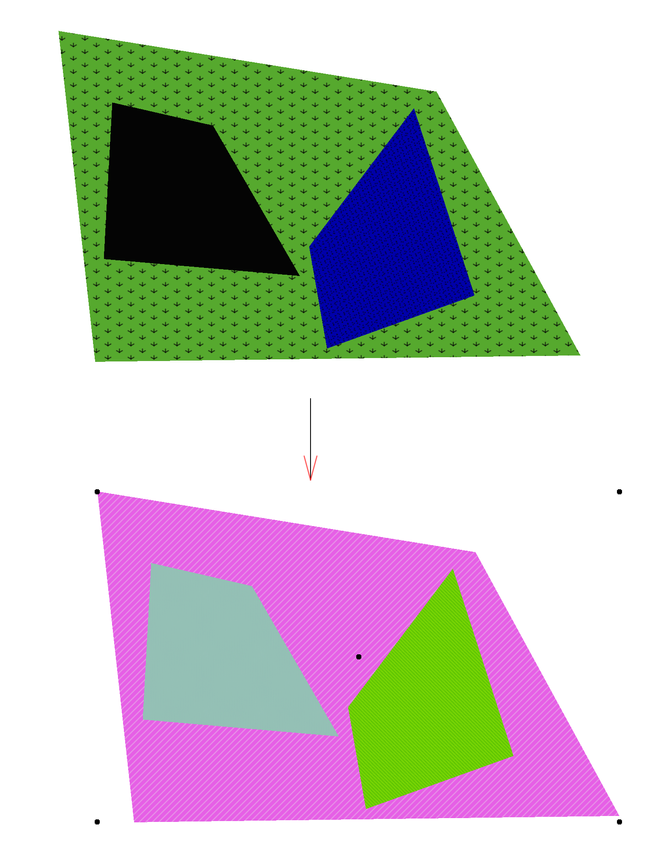

When I work on urban plan studies we normally use fills to draw the plots, buildings etc. and then give these Element-ID's to be able to override de buildings colour for specific plan views. building type etc etc. And after we have the 2D plan we model a basic 3D plan too.
So i was thinking about making an GDL object where it has a plot and building volume in 2D/3D in one go.
Now I seem to have hit a roadblock that seems like I can't give for example the building(gray fill) a unique ID or property which I can override with graphic override. It will always override the whole object?
Is it correct that this is not possible within a GDL object or is there a way to make this happen?

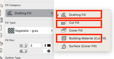

It is possible if you make your 2d object out of 3 different fill types: draft fill, cutfill and building material fill:

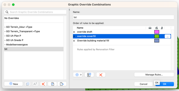

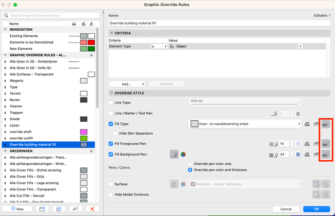

You'll have to make 3 overrides, one for each fill type:
Override draftfill:
Override cutfill
Override buildingmaterial fill
The object without and with the graphic overrides:
