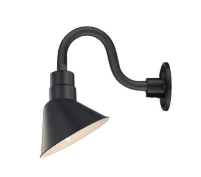

I'm hoping someone can point me to where I can find a Archicad object / model of a light similar to this one please.

With the newish beam segmentation, modelling a light like this is relatively simple. Use a shell for the bell and globe, then just save the lot as an object. AC does half decently in splitting the 3D script by object segments if adjustment is required, and will give you an adjustable surface parameter for each of your individual assigned surfaces prior to saving.
