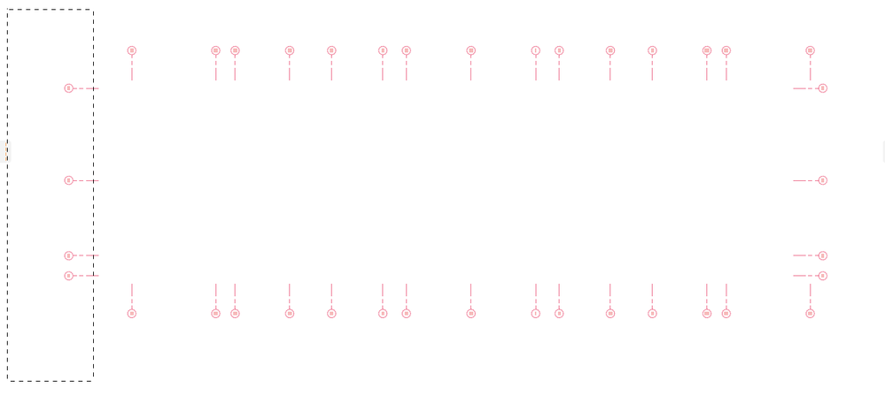

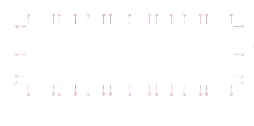

Hi everyone,I’m working in Archicad 27 and I have a problem with grid lines.I created a grid system, but now I need to extend all the grid lines at once (to make them longer).When I try to stretch them, they all move together as if I’m using the Move command.
Is there a way to extend all grid lines simultaneously or align their extents automatically?

CosminF
Unfortunately, as far as I know, this is not possible.
You would have to adjust them individually.
Same request here and I couldn't find any workarounds in the thread (just some third party plugins maybe you want to look into): https://community.graphisoft.com/t5/Documentation/How-to-stretch-multiple-grid-elements-at-once/td-p...
hope this helps.
