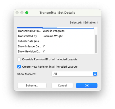

Currently coordinating with some consultants who want to know if it is possible to organize our revisions on individual sheet instance, rather than across the entire project.

if I understand correctly you want the following:
transmittal issue 1
acd-100 p1
acd-200 p1
acd-300 p1
transmittal issue 2
acd-100 p2
acd-200 p1. (No changes in this sheet)
ace-300 p2
If so it is absolutely possible.
What you need to do is add a change to a sheet (either assigned directly to the sheet, or draw a change cloud on the sheet) and that will trigger that sheet to revision up.
Also ensure you don’t tick  the option when you create a new transmittal set to override the revision of all included sheets.

Yes and keeping "Override" unticked. In the transmittal set settings.
I knew it was something simple, Thanks @scottjm!

We have the "Create New Revision in All Included Layouts" unchecked so that only issued drawings that have changed have a new revision. This way common drawings between different issue sets read the same.
