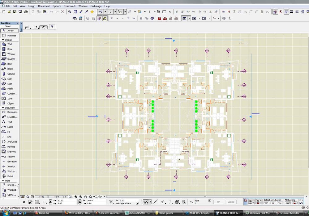

I was publishing my layouts in a pdf output (it is a large file) and the system crashed, I had a bug crash display and I opened the saved file but everything is white now (all the wall fills, objects, etc).
I am afraid that I loose my data, I am attaching a screen display, can someone help me please?
thanks!
2 Replies 2
Erika Epstein
You might just check your pen set
OPTIONS> ELEMENT ATTRIBUTES>PENS & COLORS
Sometimes it just needs to be toggled back to the correct one.

Thanks Erika!!
problem solved, I was thinking in WHY did the system crashed? I was publishing a large file consisting mainly in 10 floor plans, 12 sections and 5 elevations (all with sun vectorial option) the process took a very long time and at the time that it looked it was finished, it just crashed, do you know why?
