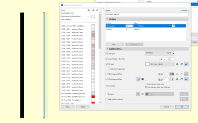

Hi all,
I'm trying to setup a plan view that shows only the concrete slabs and external walls for now. The way walls have been setup are not through layer so they are all under one wall layer for both external and internal.
I've tried to use Overwrite and turn Position: Internal to be White, but it's still showing up as white colour instead of being invisible.
Is there another way, or different settings that I need to change to make all internal walls invisible?

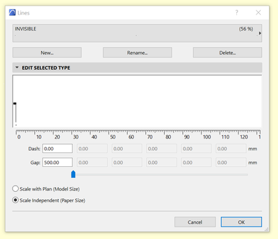

The only way to completely hide the whole element in 2D is to have it on another layer that is not turned on in that layer combo and view.   Almost all templates will have a Walls Internal and Walls External layer. Layers and layer combinations are the primary method of filter elements in the model in Archicad.
That said, I was able to fudge the graphic overrides to get it to have no fill and use a 0mm thick white pen and custom line type.
But I wouldn't really recommend this process other than for very bespoke situations where there is not other way to achieve it.

Graphic Overrides can only override an element - not hide it.
So at best you can have empty fills and white lines in 2D and transparent surface material in 3D - but the element is still there.
It is much easier to turn a layer off or on.
