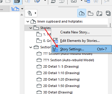

Hi, I would like to know if there’s any chance to hide the other level. I would greatly appreciate it if you could help me.
in the elevation. Thank you.

is that in elevation view then elevation settings?
11 REPLIES 11
That would depend on the storey level marker you are using.
In the elevation settings you can choose the storey marker.
For the default 'built-in' marker ...

Where I can find the photo you attached?
That is in the Storey Settings.
Solution
Just the Storey Settings  - right click on 'Storeys' in the Project Map.

The check marks on the right side determine whether that storey grid will show up on your elevaitons and sections. There is no per-view setting for it so what ever you choose will be uniform across all of your elevations and sections which you have chosen to show the storey grid on.
