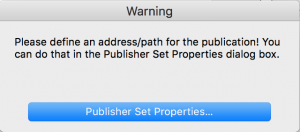

  • If you press Publish without defining the destination path beforehand (the Path field is empty in Publisher Set Properties), an automatic warning will appear asking you to define a path for your publication.
