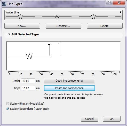

  • Step 3: Choose Options > Element Attributes > Line Types.
  • Step 4: Click New. From the Add New Line dialog box. In the appearing Dialog, select the Symbol radio button and type the desired name for the new line type and click OK.
  • Step 5: From the Line Types dialog box, click Paste line components under the graphic editing section.
    The previously captured line component will appear in the graphic editing Window.In the preview field the preview of the Line Type appears.
We need to adjust the Dash and Gap values so they are the values we want. The Dash value in our case is 20 mm. This is because we have drawn a 2000 mm long stencil on the Floor Plan at a scale of M 1:100. This gives us a 20 mm long unit size on paper. The Gap we set to 0 mm since we want the pattern to be continuous.
Click OK to accept the changes and finish creating the new Line Type. On the Floor Plan, activate the Line Tool, select the new Line Type and start drawing Line with the new Line type.
