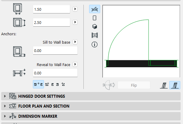

How to generally change Black Fill Background to transparent on objects, doors and windows.
How to generally change all Black Fill Background to transparent on objects, doors and windows and 3d detail to Full without changing it individually. It took me a lot of time to change it individually as I import new doors and object to the floor plan and all of the elements its because of the new template Im using. is there a way where i can change it and select it all.

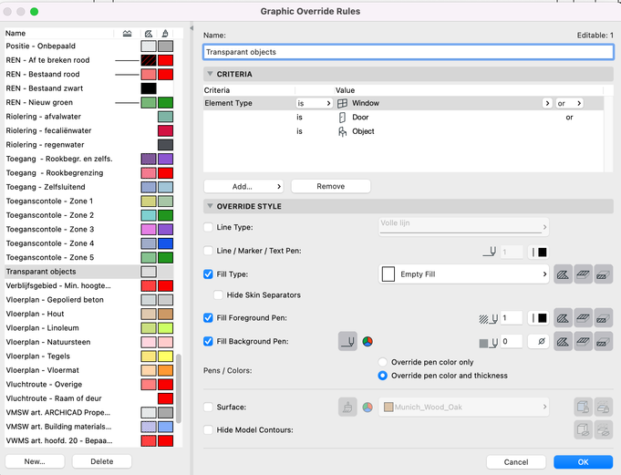

You can use graphic overrides to change all objects, windows and doors
Detail settings are available in the Model view options
Apple M1 Max 32 GB
Latest AC
Just be aware Graphic Overrides affect the entire element (object).
So if there are separate fills, say for the wall hole (opening) and another for the frame, they may both be overridden.
Also while using the overrides, you can not make changes in the object, because they will simply be overridden.
