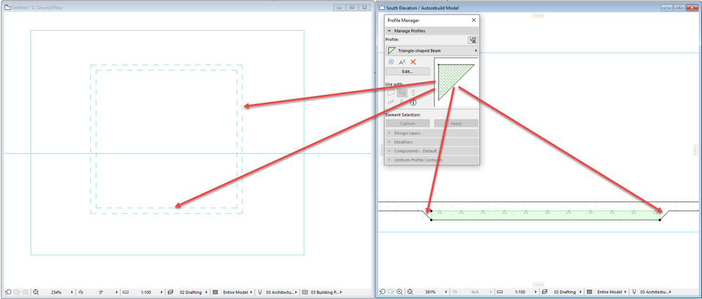

Hallo,
In the drawing of foundation, I want to draw the thickenings of the foundation slab under the columns (with the whole geometry). For the thickenings I've used the slab tool with inclined edges (Custom Edge Settings). Is there any way to show also the geometry of the bevelled and hidden edges in the floor plan?
I know It is possible in 3D document ... It would be wonderfull to have more options to show an object (a-show hidden edges, b-show ceiling projection, c-show wireframe ...)
I just hate to use lines in bim model to explain geometry - it's not bim anymore 😞
Any ideas?

... maybe I wasn't exact enough. When the shapes are orthogonal everything works fine, but the question is how to show the geometry of slab with inclined edges - how to show this hidden inclined edges below in floorplan. I can't find other solution than drawing them with lines. This is general problem in floorplan also for other types of objects not just slabs, but also roofs, morphs, mashes and shells as well. I can't find a simple way tho show hidden geometry in floorplan. In 3D document there are two options: 1. show hidden geometry and 2. reflected ceiling, but not in floorplan.

No you can't see the bevelled edges of a slab in plan.
Plans are basically a symbolic representation, and these bevelled edges are not shown.
Morphs will show the bevelled edges if the top surface is smaller than the bottom, but not if the bottom surface is smaller than the top.
With 3D Documents you are seeing the actual 3D element, so you will see all edges and if they are bevelled underneath you have the option to show hidden lines.
But I believe it will be all hidden lines and not just the hidden lines per element.
No easy way I can think of other than manually drawing the lines.
Or maybe creating a view of the 3D Document of just the slabs with hidden lines on, and then overlay that in the layout with your plan view.

You could model the sloped bottom Slab using multiple elements. The idea is to model separately the parts you want to display using a different linetype.
In the attached screenshot, I have used a 150 mm thick Slab, then placed another 150 mm thick Slab below it, and set its outline to a dashed linetype.
Then I created a Triangle-shaped Profile and used the Beam tool to model the transitions on the four sides and I also used a dashed line for its outlines. This gave me te desired Floor Plan representation.

A beam around the edge of the lower slab is a great idea, as the beam will automatically show as hidden (depending on the Model View Option Settings).
The down side is the beams are not associated to the slab, so if you have to edit the slab size/shape, you have to edit the beams as well - that is not hard.
Taking it one step further then, would be to use a slab accessory - which we have if you installed the goodies.
The downside here is you will need to create an add-on object that can add the splayed edge, and if you want to be fancy, make it so the angle of the splay is adjustable.
There is nothing out of the box that I know of that can do this.
There is an accessory that can add a footing to a slab, but it is not adjustable to allow for just a splayed edge.
