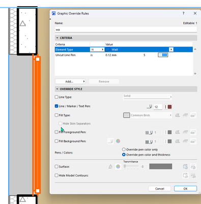

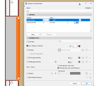

I want to change only the elevation line in the GOC in the section view. Is it possible?
AC27 on window 11
1 Solution
Remember that Graphic Overrides affect the entire element.
So even though you are filtering for walls with a blue uncut line, that will just find all walls that happen to have a blue uncut line.
Any walls that it finds will be completely changed by the overrides you set.
The actual overrides do not differentiate between cut or uncut lines.
Go to post

LeeJaeYoung
Yes, your answer makes me give up.
thank you
I'd rather apply it instead of HIde.
AC27 on window 11
Sorry, clarification.
You can 'hide' the uncut and/or cut lines of the element but you can not override the pen colour for uncut/cut lines.
I tend to work in version 22 that doesn't have that option to hide them.

AC27 on window 11
@LeeJaeYoung wrote:
Instead of the option to hide it, I said that I would like to have an option to apply only the elevation line I wanted.
thank you ^^
Yes, I understood that.
I didn't even realise there was an option to hide the lines until you mentioned it, so I just wanted to clarify for others reading this that you could hide the cut/uncut lines (as you discovered) but not change their colour.
Because in my first post I said "The actual overrides do not differentiate between cut or uncut lines".
But they do if you want to hide them.
