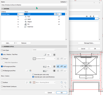

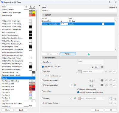

choose everything I want to exclude only windows and doors and markers.
And the problem is, among the doors, I want to choose the one made with the elevator.
The elevator has not been selected yet, so the line has not been thinned.

2023-05-01 06:21 AM
The elevator did it this way.
But what I'm curious about is how to select a marker here.

2023-05-01 08:22 AM
I am trying to create a floor plan of window signs.
Only windows, doors, and markers of windows and doors maintain their ecology, and all lines are colored gray. (Elevator Gray)
