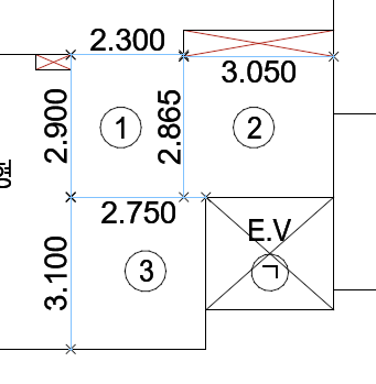

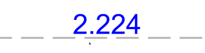

I want to turn off the horizontal line for the dimension line.
LeeJaeYoung

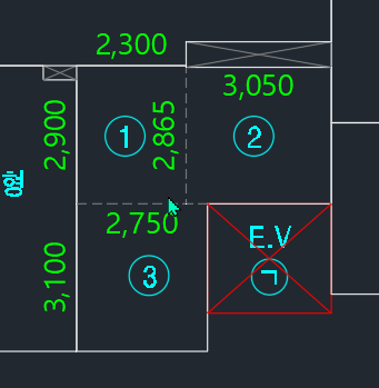

1. I want to turn off the horizontal line for the dimension line.
dimension of autocad
dimension of Archicad

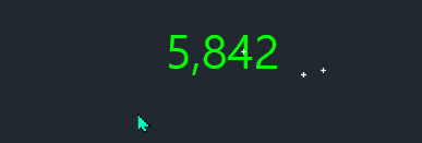

2. I want to turn off hotspot on a dimension I have xref attached to.
I want to turn off the hotspot that appears on the dimension line, but it's difficult because it's on the same layer.
I would be grateful if you could tell me how.
3. As in No. 1, the lines cannot be erased, so overlapping occurs.
Please let me know what you do in this case.

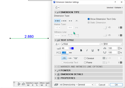

Dimensions Settings > Dimension Type > check Show Dimension Text Only.
David
David Maudlin / Architect
www.davidmaudlin.com
Digital Architecture
Thank you for your consideration for others.

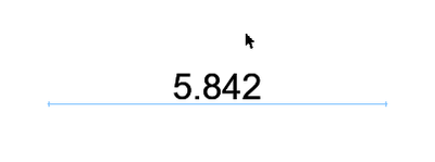

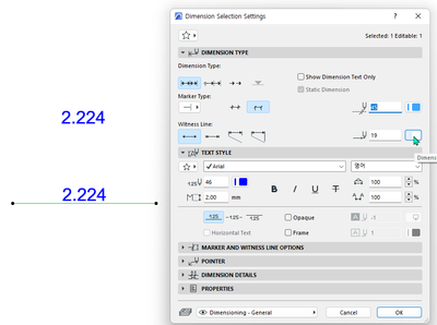

Can't I go outside like this?
Shouldn't the horizontal lines also disappear?
If you are talking about changing to the number 19 pen
You can't use display order to keep xref attach.
AC27 on window 11
