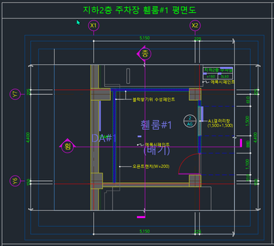

I want you to tell me how to draw a partial plan with interlocking dimensions.
LeeJaeYoung
I'm startled right now
I'm hoping you'll tell me I'm wrong.
I am preparing a partial drawing, but the lines and dimensions are not linked.
1. In the detail drawing, if the drawing is modified and then rebuilt, it is changed to a non-interlocking stupid dimension or deleted.
I'm hoping you'll tell me you're wrong.
This function is also available for partial drawings created by AutoCAD importing xref files.
2. In order to interlock, you should not put a dimension line in the center line by covering it with a fill in the plan view and making a hole. Talk about finding the end line.
All drawings are 1/500 scale. The partial floor plan is 1/100.
I have to go to the dimension at the end to put in the dimension.
And this method should not be used.
The floor plan is only in the inner rectangle and has dimensions in the rest.

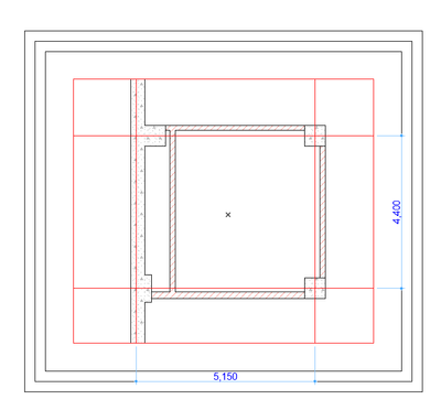

For partial plans at the same or different scales, I do not use worksheets, simply because they are not 'live' views.
I use extra layers for the annotation and layer combinations that can isolate a plan view without annotation and one that shows just the annotation.
You can then place these views on a layout, overlaying them on top of each other.
Crop the plane (walls) view to just the area you need and extend the annotation only view to show the annotation you need.
Here is an old post explaining in more detail ...

This is a partial floor plan that I am trying to create.
AC27 on window 11
@LeeJaeYoung wrote:
Would it be rude if I asked for some images?
It seems difficult for me to understand correctly.
Go to the link in my post.
It is simply just view over-laid in the layout and crop the frames to show the area you want.
