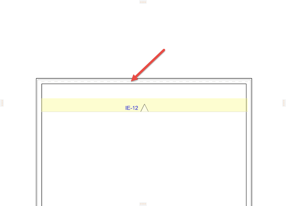

You are selecting the wrong line. Turn on the "Marker Range." (In the on-screen view options.) Pick the DASHED LINE.

rob2218 wrote:
I don't seem to be getting a "dashed" line like in your graphics.
My lines, all the lines, seem to be solid.
If you are using a limited range, the solid line will be over the dashed line initially. Move the solid line a little closer to or farther away from the marker.

1. is a "boundary" line, and as far as I can tell, sets many of the overall extents as well as direction of the marker.
2. Is a view limits line, and basically tells you where your view "stops." You can add "bounded area" and get views beyond.
3. In the horizontal range selections, the one with the horizontal dashed line tells you that the view stops where you've set it. The one that is open tells you that the view will keep going until it hits something solid.
4. The online options just turns on a display of where the view starts and stops. It doesn't control anything.
You might want to consider not stopping the views right at the face of the wall, but extending them "into" the wall. Jared Banks has a good video about this, showing the advantages: http://www.shoegnome.com/2014/01/06/interior-elevations-in-archicad/
