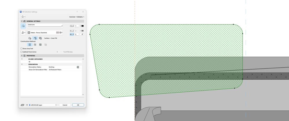

If you are using Archicad 25 and forward you can use a fill set as Surface-Cover Fill.
Instead of a fill create a material with the png and set it in the fill selection settings.
Check the photo for settings.
For fill background set the transparent option to enable the transparency channel of png.
I do not remember if surface cover fill existed before 25.......

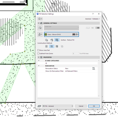

Thanks for your reply Botonis! I have managed to get the png to function with the Surface - Texture Fill, but not when using Surface - Cover Fill. However, there is still no transparency using the Surface - Texture Fill option.
This also doesn't appear to function with a transparent png texture that is built in. I assume transparency works in the same way as it does in 3D where there are issues with multiple overlaid transparent objects.
