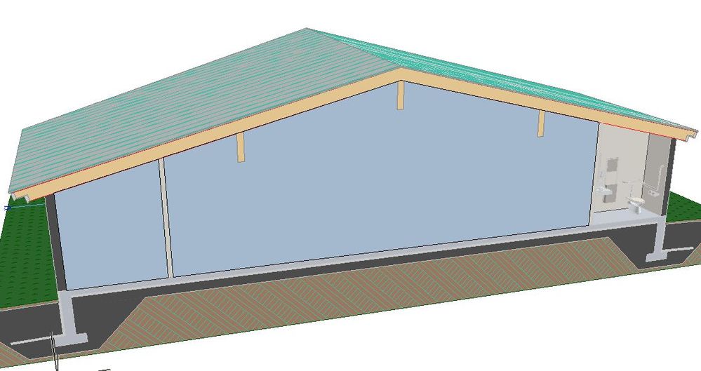

I'm having some major grief trying to figure out how to get angled walls to display in an interior elevation. I've played with all settings that I can see but can't get it to work properly.
See the attached plan (in the following posts) to see the walls I want to display. I want to display the main wall and the two angled walls as one elevation. The ceiling is sloped and I want this to display properly. I have a 3d zone that is SEO'd to the correct shape (see attached.)
I've tried two scenarios:
1: limit line follows straight wall.
2: limit line is placed to the interior of all the walls with 'add bounded area' option
See the following posts for descriptions of my problems. Any help would be greatly appreciated.

SCENARIO 01: Limit line on straight wall
With 'Consider solid operations' is checked, the straight wall displays correctly. However, when it's not checked, all the walls display correctly but then the slope of the roof is obviously not proper.
Results when 'consider solid operations' checked.
Results when 'consider solid operations' unchecked.

SCENARIO 02: Limit line inside of all walls, with bounded area
