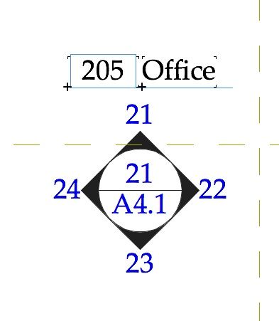

I'm just wondering how people name their interior elevations on a sheet. Do you have a separate drawing title for each? That could get long (ex: 101 - Powder Room, North) especially when each interior drawing may be really small. I run into problems with the interior elevation marker and having it actually link to a drawing on the sheet: we've been using only one drawing title for all the drawings and turning the rest off. Without going into the complex idiotic way we've done interiors, I'd just like to know how other people name/label their interiors and reference them to a sheet (especially when you have a room with more than 4 sides!). The interior elevation marker and I haven't always gotten along...

Steven wrote:
...That could get long (ex: 101 - Powder Room, North) especially when each interior drawing may be really small...
Steven:
For small rooms, I will abbreviate the title, so this would be Pwdr Rm N Elev. If you have the North Direction set correctly, you can have ArchiCAD add the cardinal direction automatically, so the titling is automatic.
Also, in your marker.jpg image, you can turn off the interior elevation number inside the marker, so only the sheet number is shown, with the elevation numbers only on the outside as you have them.
