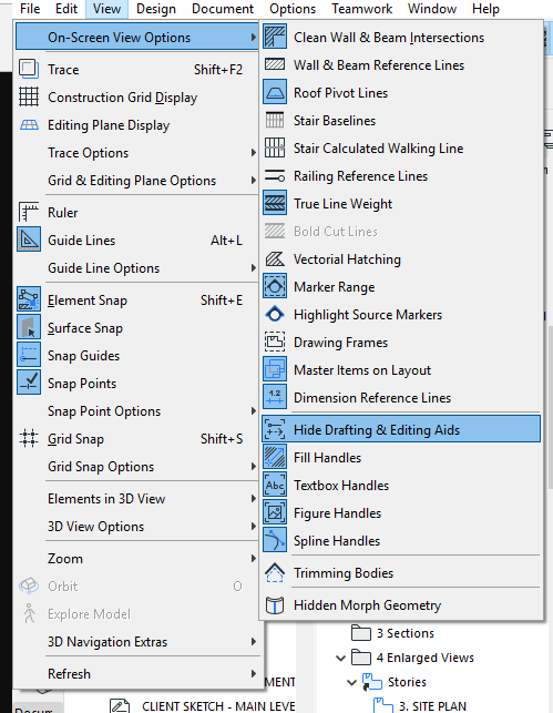

This helped me a bit:
View/On-Screen View Options/Show Drafting & Editing Aids
