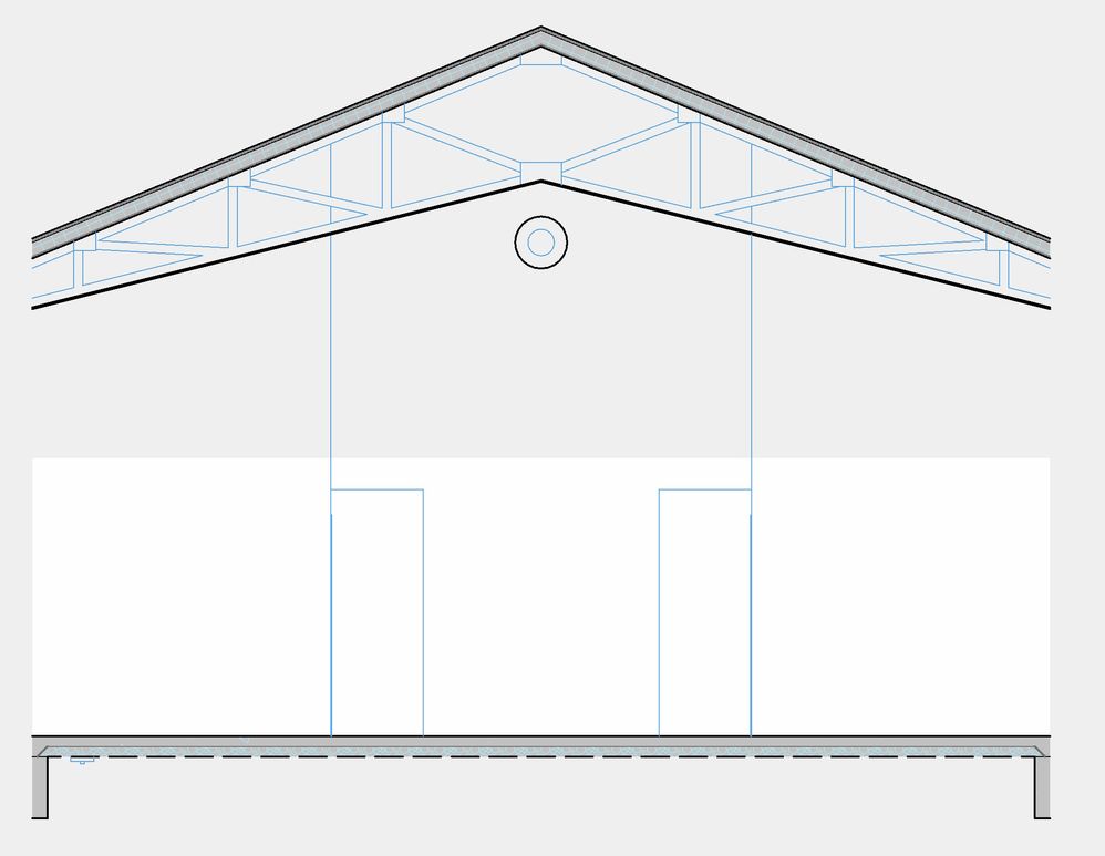

I have a (2) story Classroom wing. Both floors have sloped ceilings from 8'-6" to 10'-6" (Interior wall to Exterior Wall). Both floors have Zones (shown as Test1 & Test 2 on the attached image) that have been trimmed to the sloped ceilings. The Interior Elevations have been drawn in with "Detect and Fit to Zones" selected.
But, when I pull up the Interior Elevation it is displaying the entire elevation from foundation to roof.
Am I doing something wrong, misunderstanding the capability of the Interior Elevation tool, or is this an issue with the software?

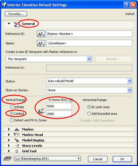

It's annoying when the Interior Elevation Tool doesn't behave. You can of course cheat a bit here by punching in the values of the height of the storey up to the highest point of the sloped ceiling. You will then have an Interior Elevation that is covering a little bit more than asked for... It will maybe be better than your IE from bottom to top?

If this worked as it's supposed to, nothing above the ceiling nor below the floor line should be visible...IE.jpg

This looks like a known bug, DEF-10370. The issue is that the 'Detect and Fit to Zones' function might consider zones on the other side of walls or from neighboring stories, not only those that are in the Interior Elevation range. The workaround is to set the vertical range manually. Sorry for any inconvenience caused by this issue.
