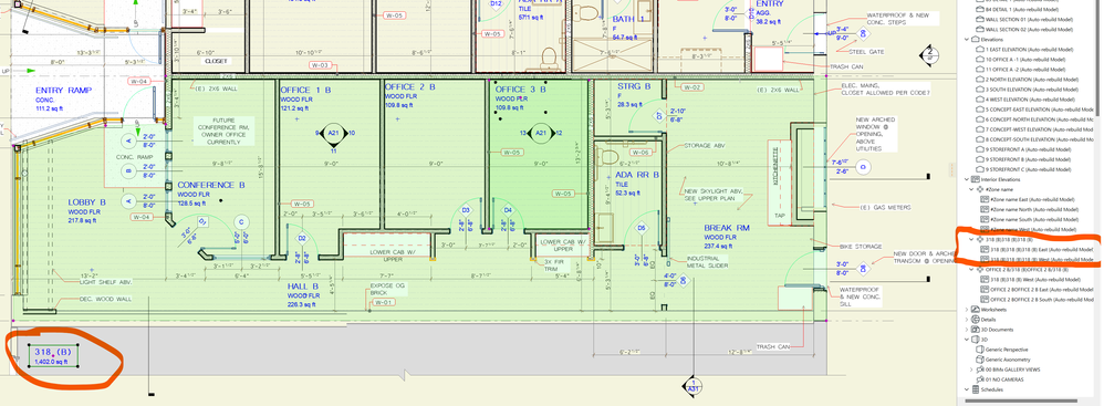

reidweber
Hello,
A few years later, I have a similar question relating to IE automatic naming with zones.   I have an overall square footage zone and a room zone for this project. When I place an IE tag it automatically pulls the name from the overall square footage and not the room specific zone tag.   Is there a way to specify which zone to pull information from when they overlap?  I tried to filter one zone out by putting it on another layer but no luck. Maybe there is another workaround with this with zone ranges options?
Interestingly, the IE happened to pull the right zone information that I wanted for the "Office 2" but I have no idea if that was just randomly picked over the larger zone.  There must be some sort of rationale behind how IE's prioritize zone names.
