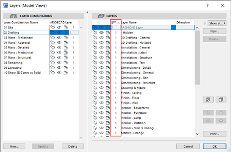

So today I'm trying to control intersections.
I'm using layers to create different design options.
ie: Layer A contains design A, and Layer B contains design B.
I then hide a particular layer, depending on whichever design I'm trying to display.
But I find that the hidden elements of Layer B cuts/intersects elements in visible Layer A and vice-versa.
I don't want to change the intersections of the composites/materials as it will probably cause loads of challenges elsewhere in the model.
What would be the best way to prevent these cut-outs?
The example shown is walls on visible layer A and slabs on hidden layer B.

Making sure that the hidden layer doesn't have the same Intersection Group Numbers (the number showing in the layer dialog) as any element it intersects in space should solve it. Remember to update the Layer Combination.

To fix this, you need to change the Layer Intersection Group.
Intersecting elements that belong to the same Layer Intersection Group will be joined to each other. Elements on different Layer Intersection Groups will not be joined.

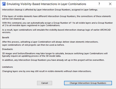

If you have many layers that you need to change the Intersection Group automatically you can use the Intersections in Layer Combinations Add-On from the Options menu.
The Intersections in Layer Combinations Add-On will set, for each Layer Combination, a Layer Intersection Group value 1 to all visible layers, and a value 2 to all invisible layers.

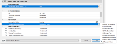

I use the renovation filter for options when doing remodels too. You can't create filters I guess but you can create a new option and still pin items to it. I used to use layers but found once I got the process down it's much nicer using filter options rather than mass amounts of layers. This really comes down to how many options. I have plans for builders with up to 12 options all in the same file and only one set of layers.

It is possible to set elements to show on only one Renovation Filter so by creating different filters for different alternatives it is possible to set up views for different alternatives without using different layers. A crucial limitation is that it can only be set to one filter.
 Element Settings Dialog > Classification and Properties > Renovation
Through the Renovation palette you can pin default or selected elements to the current Renovation Filter.
