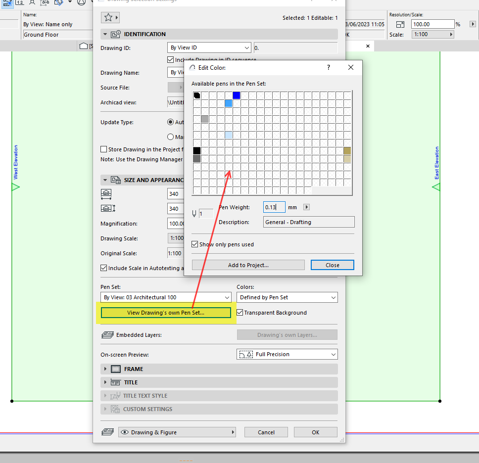

Lines do not have a thickness, it is based on the pen you choose.
So viewing the line display will not give you any information on the thickness.
Only the pen set can show you the thickness set for each pen colour.
In any of the views you can only see the entire pen set.
But if you place a drawing on a layout, you can go into the drawing settings and view just the pens used in that layout.
Does that help at all?
