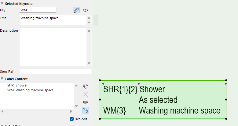

My Keynotes are displaying with additional numbers in brackets, any ideas if this is a setting i need to switch off or a glitch or ????
Keynote Key and Title for Shower - Displays as  - SHR{1} {2} Shower
Keynote Key and Title for Washine Machine - Displays as - WM{3} Washing Machine Space
Also, as soon as I try to manipulate the size of the frame using the hotspots, it freezes my Achicad for approx 36secs! Basically I can't use the tool.
Any ideas?

Hi Ashlee, I checked the CI Tools Installer and found an update for the Keynotes. It appears to have worked for now.

Hi, I am having the same issue. Have you resolved the problem?
AshleeDesign
Hey Chopper, I haven't. They have told me they are aware of it and working on it. No luck in the Hotfix 28.0.2 (3110)
In relation to the Freezing Issue, I have found that when I am trying to manipulate the size of a keynotes label with the hotspots, if I hover my mouse over the Main Toolbar at the top of the page, it unfreezes. Go figure, but it works!
Would love to hear from you if you figure out any work arounds.
Cheers

Just received an email from CI, Problem solved!! Thank goodness.
