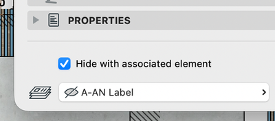

I have only recently started using Keynotes.  I am also a heavy user of the Quick Layers palette.  I notice that the keynote labels in plan view cannot be controlled by quick layers.  For instance if the keynote labels are on archicad layer, and I select "hide all layers, the labels are hidden.  And when the labels are on archicad layer, or any other layer, and I select a label, then click "hide others layers" the keynote labels disappear.  Is this a bug or am I missing something?

Check your Label Settings for:
