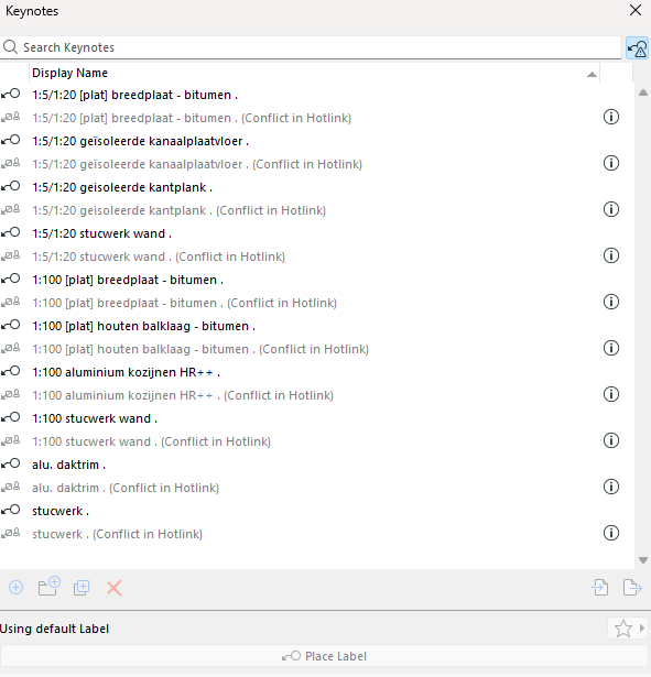

We are having a issue with the Keynote function when importing an IFC-model from an external bureau (structual engineer or installer for example).
We provide them with our IFC-model, they use it to make their plan and send their IFC-model back to us.
When we import their IFC-model some of the keynotes used in our drawings go into conflict with the hotlink (see image).
According to Graphisoft, Keynotes don't get exported when exporting an IFC-model, so we don't know why is conflicts with our hotlinks.
(We have had this issue with multiple projects).
We can't find a way to exclude Keynotes when importing/exporting a IFC-model.
Does anyone know a solution to this?
Would like to hear from you!

Much better, we can see that image now.
I am afraid I won't be of much help.
I don't use keynotes and I don't use IFC files either.
What happens if you click on the information button on the right hand side?
Does that shed any light on what the problem might be?
2 weeks ago
Ah thanks for your confirmation.
The information button on the right hand says the following:
''This keynote has a different Description than in the host file or other module.
The Description or this Keynote will not be displayed in Labels or Legends''
This is because the information/text in our Keynotes have been changed between the moment of exporting our IFC-model and importing their IFC-model.
We use Keynotes as a autotext in our detail drawings, so the information changes sometimes as the project moves on.
Therefore we would love to have a solution to our problem, because it is verry annoying.
We would love to hear from someone that is dealing with IFC and knows a lot about the export/import settings.
