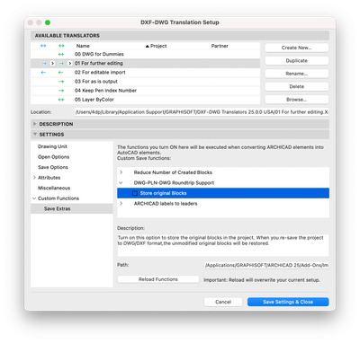

We use the Kitchen Layout object in our high-rise residential projects. Recently we've started having problems when we save DWGs of the plans. The configured Kitchen Layout objects export in their default state - not their configured state.
Has anyone else seen this? Is there a bug in the code?

make sure this line is unchecked on your translator settings: 

Thanks!
