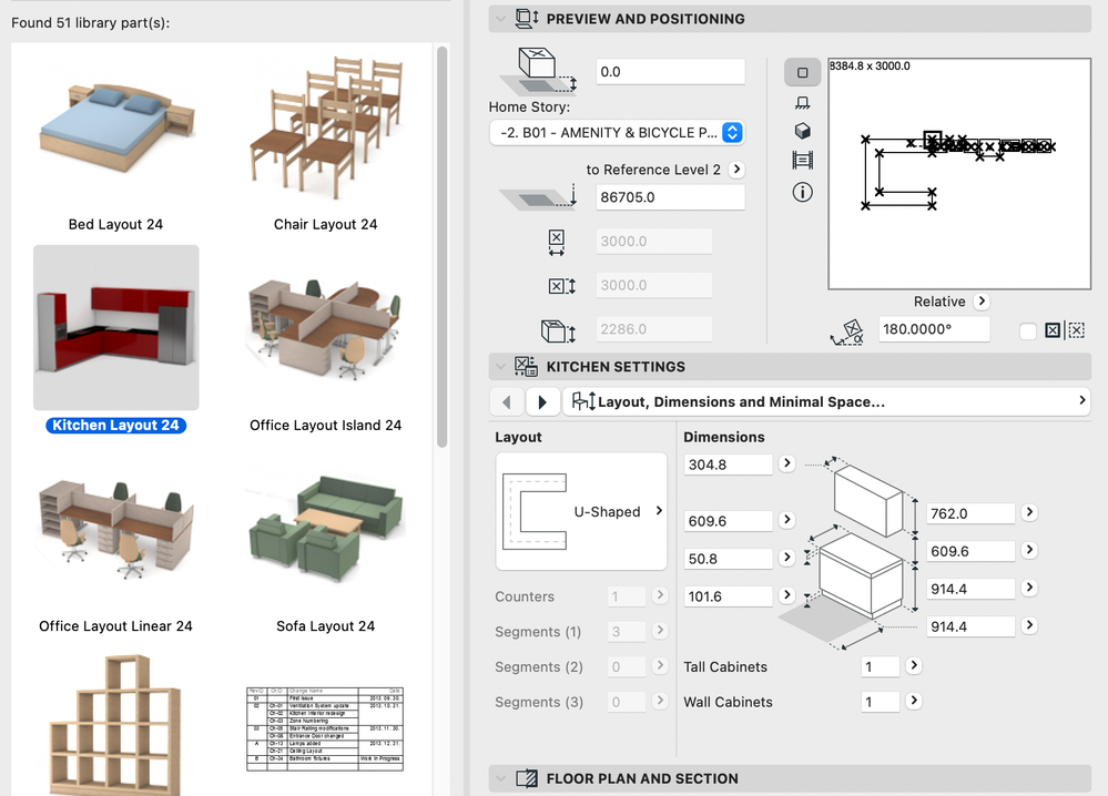

We use the Kitchen Layout object in our high-rise residential projects. Recently we've started having problems when we save DWGs of the plans. The configured Kitchen Layout objects export in their default state - not their configured state.
Has anyone else seen this? Is there a bug in the code?

2022-02-10 10:08 PM
what object is that? mind sharing a screen dump?
2022-02-10 10:13 PM
the kitchen layout is one of a number of "layout" objects.
2022-02-11 09:00 AM
Ah that one...thanks. We call it sketch kitchen 🙂 and we have a more localised one
