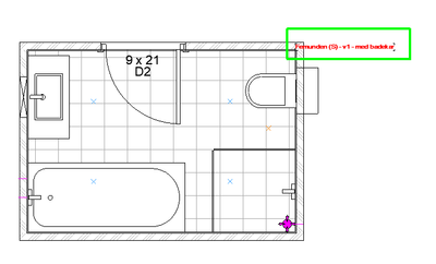

1. Made *.mod file like this with horizontal LABEL on bottom left corner:
2. Placed *.mod file in Teamwork file and rotated it 180 degrees with "Adjust angle of fixed angle object.... " ticker on. LABEL placed in top right corner:
3. Other users in TEAMWORK project see same *.mod file LABEL it's shown below with text out of *.mod file. Also If I LEAVE Teamwork project and JOIN again also I see this LABEL jumped out from its position.
I have ~50 such mod files in my project.

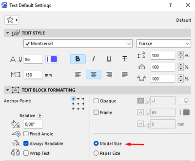

You are not scaling your texts with the current scale of the project then? (Scale with plan/Model size?)

2022-06-16 10:38 AM
Looks like I described issue a bit wrong. This is not text, but its label 😞 and labels do not have "Model Size" parameter. I need to use label because it takes parameter (Name) out of door element inside *.mod file
