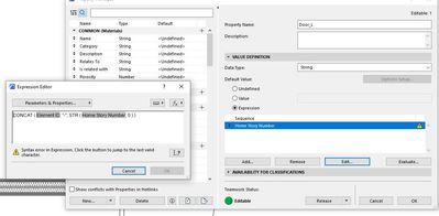

thanks, it helps me to understand what i  have to do, but also it takes many time to custume label for door or is there any other whay to do it inside door stamp marker from classification and properties ?  see attached photo

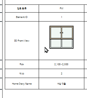

And I've never tried to put a level into a door or window. Because it is fully expressed in the schedule.

You can create property that will combine door ID and storey number or storey name:
CONCAT ( {Property:General Parameters/Element ID}; "-"; STR ( {Property:General Parameters/Home Story Number}; 0 ) )

ladystarlight
Thanks it works now, I needed this numbers on plans in door ID and according them are all door shchedules.

ladystarlight
thanks, CONCAT ( SPLIT ( STR ( {Property:General Parameters/Home Story Number} ), ".", 1 ), "/", STR ( {Property:General Parameters/Element ID} ) ) this is exact answer what i was looking for 👌
