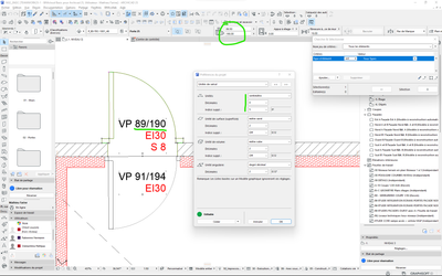

So I am using labels with autotext to show the width and height of my doors.
I have a problem with the decimals of these labels..
How can I solve that?
Thanks for your help!

I noticed that Extra Accuracy works for Dimension Markers but not for Labels with Autotext only for Archicads Opening Label or Door/Window Stamp, or Dimension Label, but you have to select Extra Accuracy in Project Preferences>>Dimentions>>Dimentions Type for Windows/Doors. For your Label you can select decimals 1 but than it is 89,5x190,0
2022-08-05 09:35 AM
Thanks for your answer!
Mmh but then I cannot get dimension and property in one label..
I guess I'll do without it for now!
2022-08-05 09:36 AM - edited 2022-08-05 09:37 AM
For exemple it is Dimension Label
or Window /Door Stamp
2022-08-05 09:49 AM
But it dependts what property, for Door/Window Stamp it is posible to show some properties like Fire Rating or other.
2022-08-05 05:04 PM
To get other number formats and / or get more or less decimals as global set...
... for use in labels, it's possible to write appropriate properties.
e.g. something like this:
CONCAT ( STR ( STRTONUM ( STRCALCUNIT ( {Property:ProfileParameterPropertyDefinitionGroup/Balkenbreite} * 1000 ) ); 0 ); " mm" )
You've to get a bit worked in this subject until you get to know all the settings and operations...
