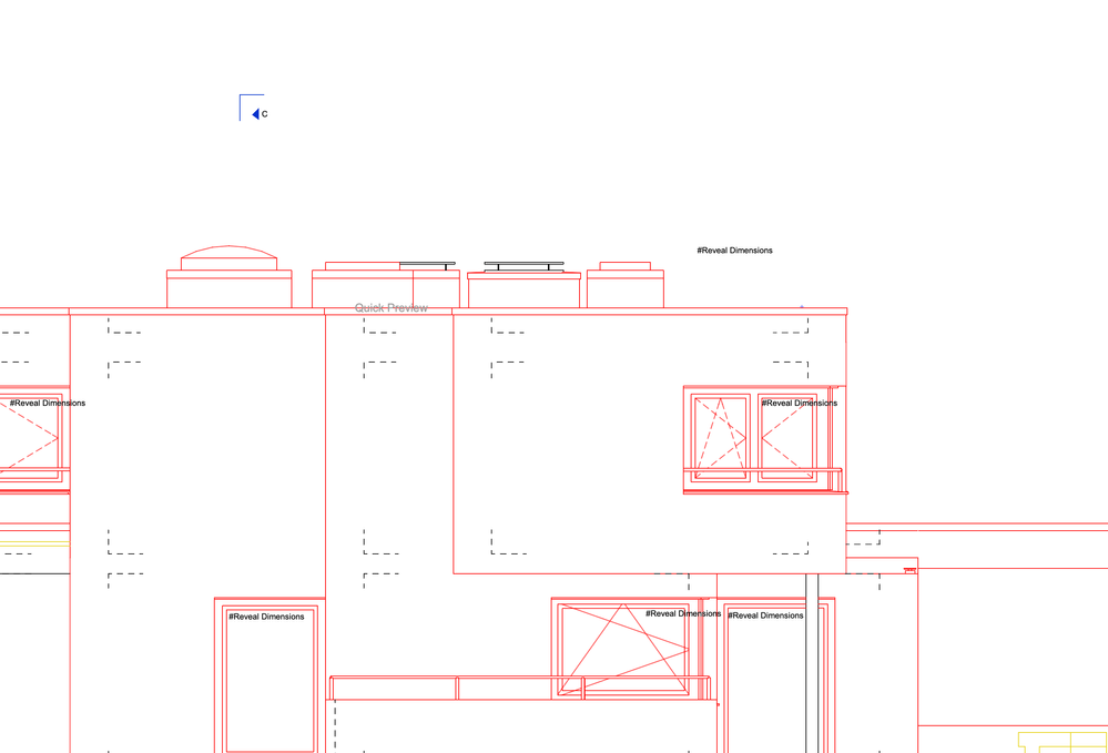

I've created a label with simple Autotext for measuring windows (#RevealDimensions).
When placed on the windows in Map View, it works perfectly, but when I place this view on a Layout the label only shows "#RevealDimensions". It seems as if in Layout it reads the label as text, and not as a label. What should I do to fix this?

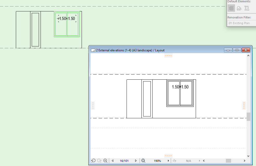

‎2025-09-18 08:50 AM
Hey Barry,
Thanks for the reply. That is exactly what I had done and why I can't understand where is the problem. I am attaching two images: Model View and then same drawing placed on a layout. Any other ideas?

‎2025-09-19 08:32 AM
I am using Archicad 25. I had created a new Label from scratch using Autotext, and that wouldn't work in the Layout.
I decided to just use the already existing "Text/Autotext" label instead and insert there the Autotext I wanted (#RevealDimensions). This alternative worked!
Like this I managed to solve the problem. Thank you for the help!
