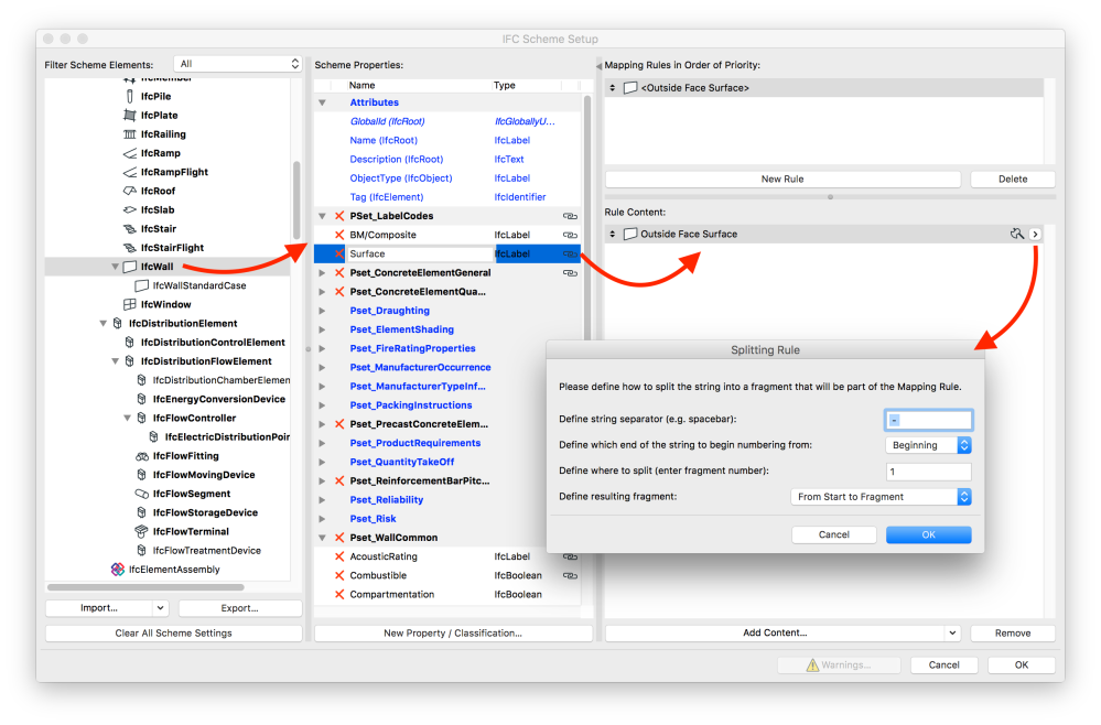

1., Open the Scheme Setup from a floor plan viewpoint (File/Interoperability/IFC/IFC Scheme Setup…).

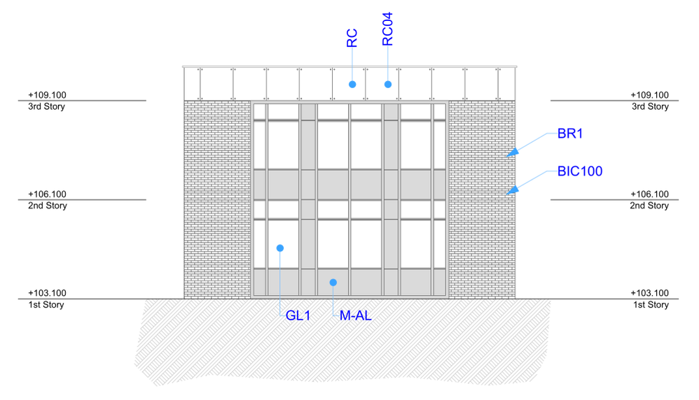

You will need to create custom IFC properties that will be included in the Labels for Walls, Slabs, Curtain Walls, Roofs, Shells, depending on what purpose you want to use the labeling for. In this example I created one for the Walls and Curtain Walls to annotate the elevation drawing.
2., Create two New Properties under a new Pset, such as LabelCodes for mapping the BMs or Composite and the Surfaces.
3., Set the GENERAL/Building Material / Composite / Profile / Fill for BM/Composite and the WALL/WALL/Outside Face Surface for the Surface property.
4., Click the little arrow under Rule Content to Add Splitting Rule and set as per below to get rid of the ID you added manually to the attributes:

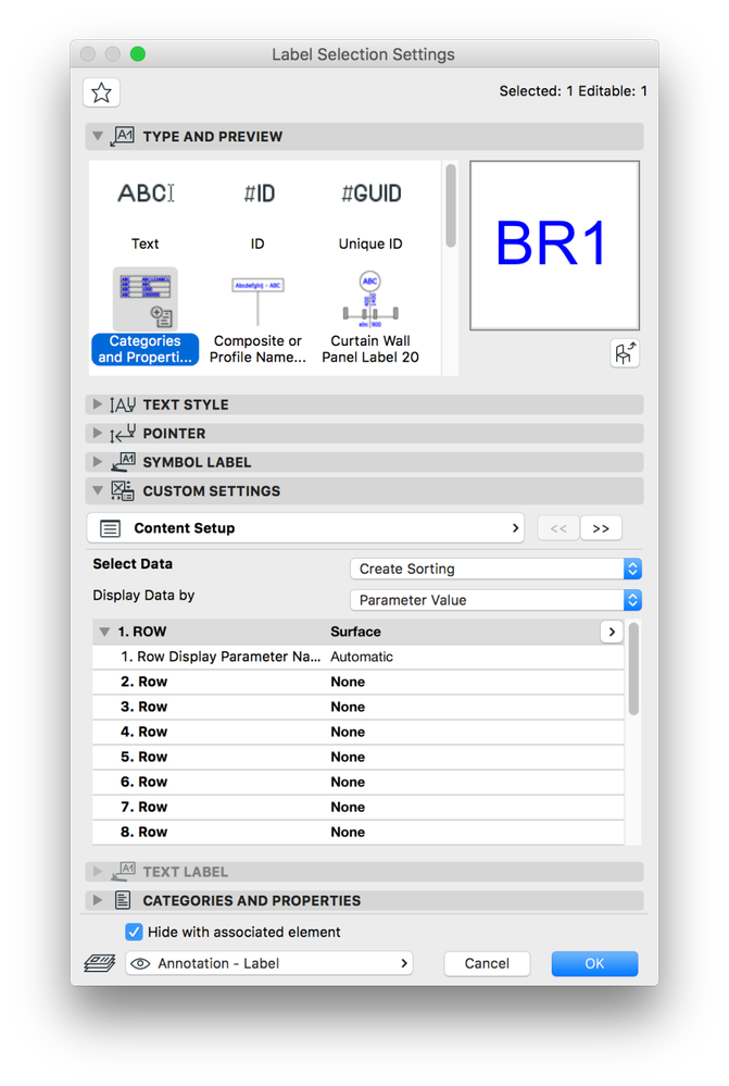

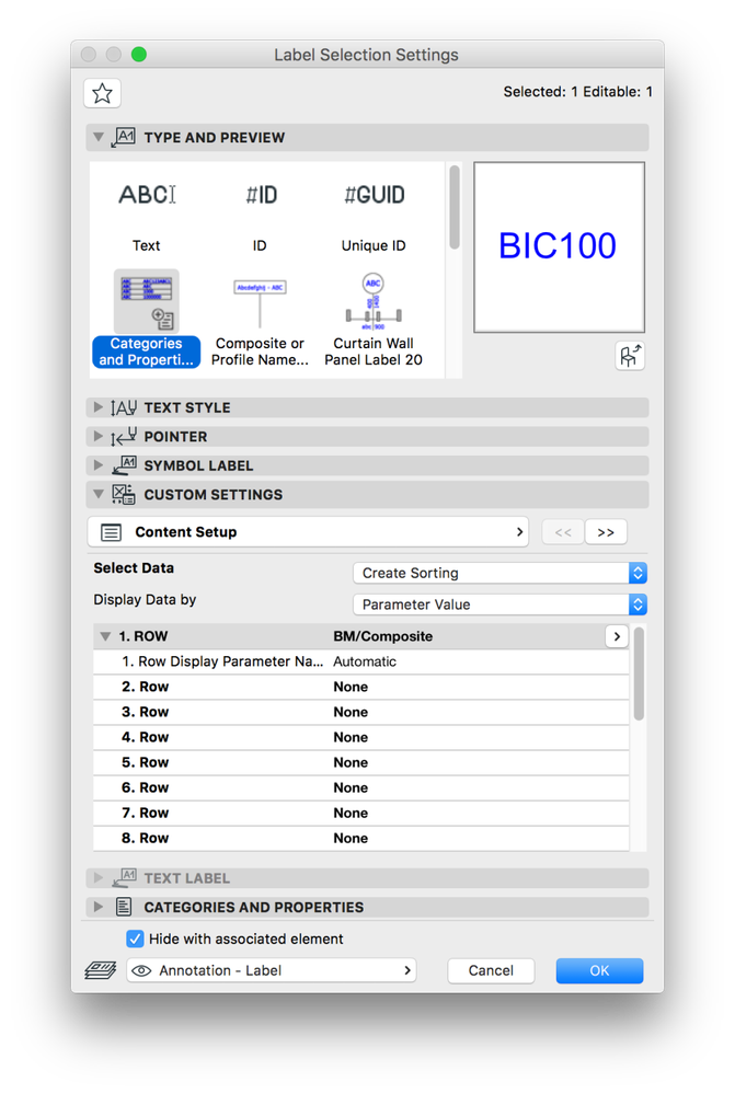

1., Use the Categories and Properties type.
2., Set the newly created IFC Properties depending on which data needs to be displayed.

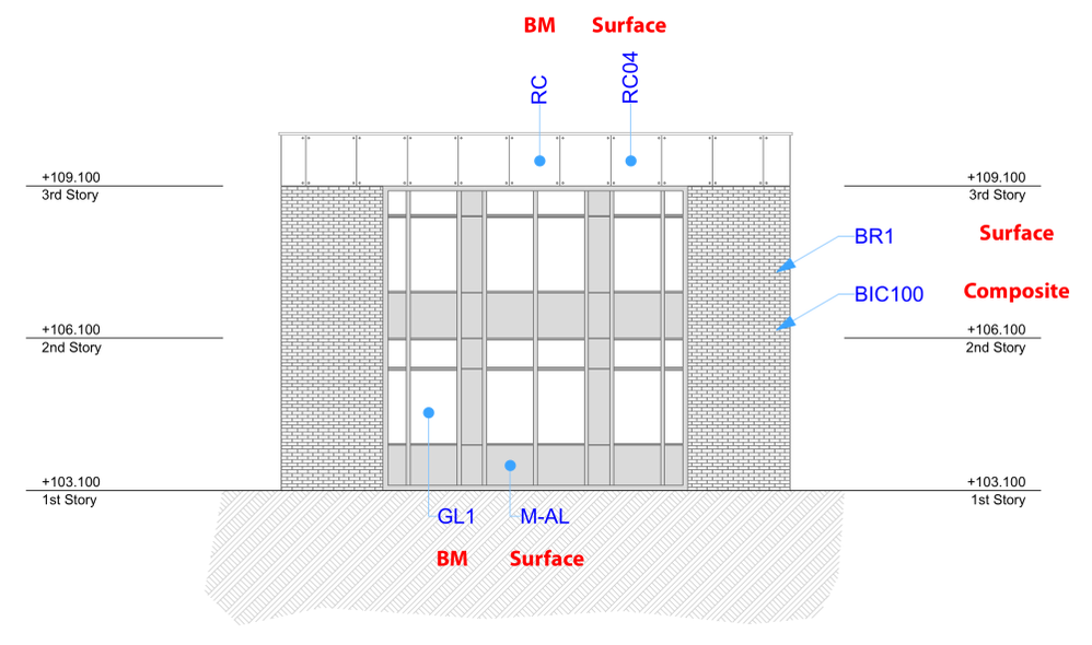

3., Apply the labels. See below the origins of the data:

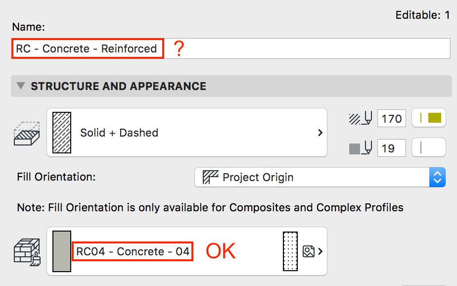

So far this worked well, but let’s see the issue with the Building Material-based labels. BMs do not really require the IDs added into their names, since they have an own distinct column for this data, which can be displayed in the Skin List label as an only value (ID of Building Material).
However if it is part of the Name itself, then it cannot be split in the same way as the custom IFC properties which results in strange annotations.
As a summary, to keep it simple it is better to leave the BM names without the ID because of the Skin Lists, and even simpler try sticking to the Surfaces and Composites (and Complex Profiles).
However if you still want to use the ID in the BM name as well and split the data for the other label types, then as another workaround use the BM names without the ID as Description of Building Material in the BM settings and set them for the Skin List label… or name the Cut Fills creatively and choose the Name of Cut Fill option.
