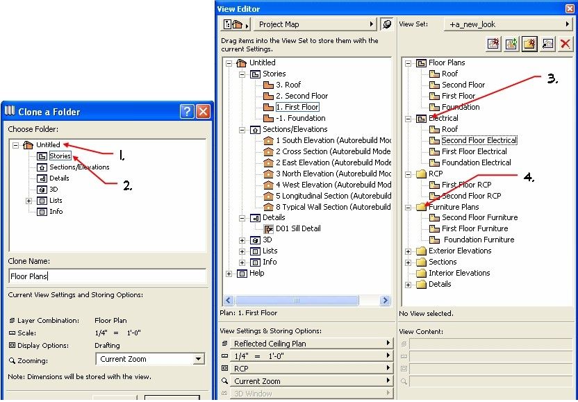

Sounds like you are creating clones. If you use clones to create views it will duplicate everything in the project map with the settings in use at the time the view is created if the clone title is highlighted (1. in picture) and will only duplicate each Story's view if that is selected(2. in picture).
If you look at the View Editor in the picture, the floor plans and Electrical Plans (3. in picturE)are clones. Every time a story is added to the project, the Floor Plan and Electrical Plan view will automatically be created.
If you look at the RCP or Furniture Plans (4. in picture), these have been created by dragging the floors for which we want these plans over to the proper folder in the view set.
Notice that in the cloned views ALL stories show up and in the non-cloned views, only those we choose show up.
Hope this helps.

I see - hmmmm
And the purpose of the cloning?
I am reading in the help text that using a clone will automatically update any changes that I make. Does that mean that if I drag and drop a particular story (with its current settings), I am simply creating a 'snapshot' of that moment? Changes that then occur within the project map are not automatically updated to that 'snapshot'?
If that be the case, then I guess I need to decide what, exactly, I am looking to do. I want to be able to have different views of, say, the floor plan with info on here and off there. But if I have to move an interior wall for some reason, I need that to update in all those views. Is this possible?
Cloning can be useful if you are going to do a large building and have no idea of how many stories there will be... or for starting to develop a template.
For smaller projects they might be most useful for Sections and Elevations or Details.
Whether it's a clone or views set up within a folder structure views always reflect the content of the project. Views are about the way you look at the content. The View Set in the previously posted picture is a part of my template. When a project is begun I don't need to worry about what layers are on or off, what the display options are, etc. That's already taken care of by the View Set.
