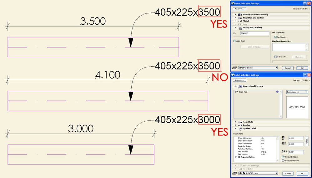

I've just been playing around with automatic labelling. It is not something I've really looked at before so I may have missed something! I'm also using AC11 with the latest patch.
I've labelled a beam created using the beam tool, with the beam label set to show X,Y and Z dimensions. It displays fine when I first set it. The problems occur if I stretch the length - it doesn't always update properly!
This probably happens over 50% of the time, and could be a big problem if you don't spot it. Interestingly this only occurs if you resize the beam in the same axis. If you stretch it so it forms an angle, it updates correctly. The label will also update correctly if you modify the labels position slightly on plan. Neither of these solutions qualify the usage as 'automatic'!
Hopefully the image below will illustrate the problem. The top beam is the original length and displays correctly. The middle one has been stretched but has not updated . The bottom one randomly decided to update after half a dozen resizes!
I have also had a play with this in AC12 and it seems to work correctly for some reason, so maybe it's AC11 specific. The code looks identical. Hopefully I'm doing something wrong as this could be really useful otherwise!
Does this work correctly for other people?

I get similar behavior to you, Peter. When I stretch the beam the label does not update. If I stretch twice, then undo once, it does update, however.

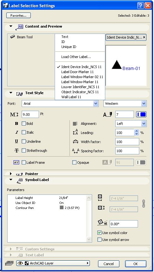

OK. I'll bite. Where did you get the BEAM Label?
Is this only in the international library?

These are the default labels in the INT library. I will attach the beam label to my next post if you would like to try it!
Beam label attached.

The label updates perfectly for me here (AC12 2523 INT FULL), but I don't get the arrow.

The equivalent AC12 label works in 12 for me as well, so it seems this is AC11 behavior only.
To get the arrow to appear I had to uncheck 'use symbol arrow' in the symbol label settings!

Yes, I should have been more clear and said that your marker works fine for me in AC12, so it must be an AC11 issue, exclusively.

The Reference Guide does say this about the 'Use Symbol Arrow' checkbox:
Use the checkboxes to display the Symbol Label with its own internal color and/or arrow. Leave the boxes unchecked to use the color and arrowhead preferences defined in the Pointer panel.
So it does kinda make sense in a GS kind of way.

Yes, it is not clear enough. Actually, you can create your own Symbol Label in GDL which can be anything and is not necessarily an arrow. Then you can control with the symbol arrow checkbox whether to use the arrow put there by AC or the arrow or whatever else you defined in the script of the Label. The color checkbox lets you decide whether you want to use the color defined for the Label in the Settings Dialog or you want to define colors for you symbol arrow in the 2D Script of the Label and apply that. This is similar to what is available in the Object Dialogs.
I will let the guys at GS Publishing Department know about this.
