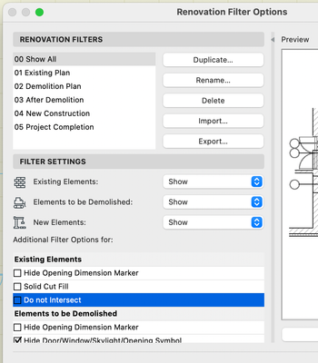

In the Renovation Palette uncheck the "do not intersect"

Yes, that has done it, i knew i was missing something simple.
Thanks so much.
