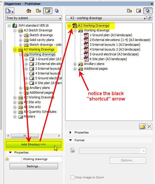

Im in the process of setting up a template for our office to use, and I want to simplify the print/publish process. So i have setup a series of different publisher sets (full size, half size, full size color, half size color, pdf, etc..) and I have a basic layout book setup and put into the publisher sets.
The problem i am having is, if an employee adds a layout, in the layout book, it doesn't automatically get added to the publisher set that the Layout subset is assigned to. You have to manually open the Organizer and drag and drop the new layout. Is there any way around this?

Don't drag your layout pages to the publisher sets.
Select them and use the "Add Shortcut >>>" button.
If you have your layout pages in folders then you only have to add a shortcut for the main folder.
Now if anything changes in the layout sets then the publisher sets will update automatically.
