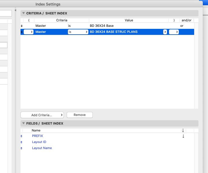

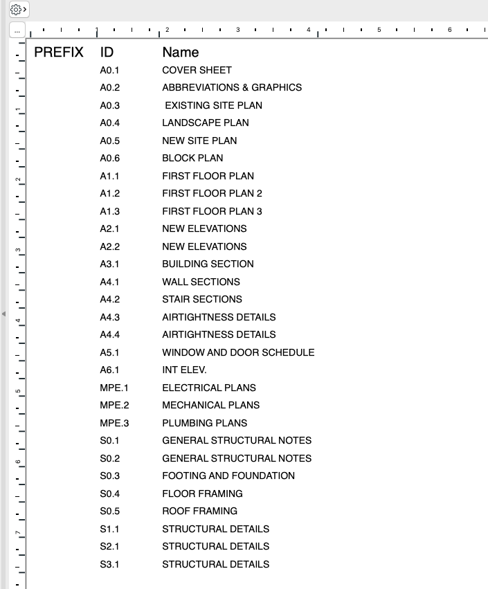

I create a "sheet index" for every project and place it on my cover sheet.  Currently I control the layouts that show in this index with the layout master, ie as I develop my layouts I assign one of our two masters to the layouts I wish to show in the index.  Any layout that is not ready, I assign another random master (like an 8.5 x 11 master).  Then I take the layouts that are "ready to publish" and drag them into my "layouts to pdf" publisher set.  But I would love to eliminate a step and just have any layout in the "layouts to pdf" publisher set just automatically show in the sheet index.  Any way to do that? or any other ideas?

If you add your subset to the criteria it will do what you are after
