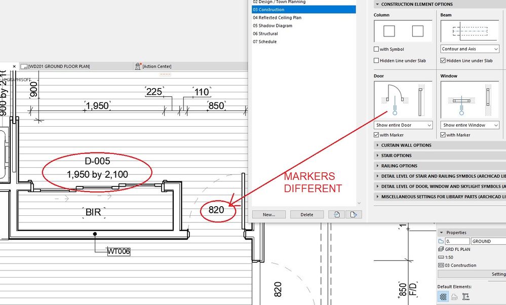

MARKERS FOR DOORS ARE DIFFERENT
The settings for Door markers in model settings don't seem to control Sliding doors width (only)?
(Please see attached)
I added a marker to Sliding doors inside the settings for individual door settings.
1 Reply 1
cadsph
That's ok.
I solved it. I found hinged doors has an addition setting for showing leaf width!
