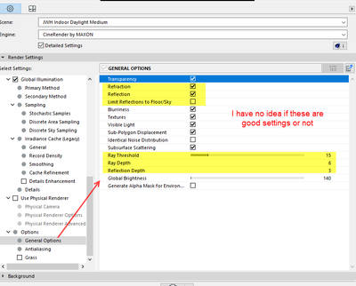

I want an interior render with "indoor lamps only" settings. The mirror in the interior space does not reflect the interior space in Cinerender. The rendered output shows a blackout area instead of reflection. I checked with surfaces settings, the environment is turned off. Please help!
2021-11-19 08:34 AM
No idea what that preset contains, but are Reflections turned on?

Hi ayush_lohia, How did you fix the issue as I seem to have the same problem? "Environment" is switched off and I don't get a realistic reflection of my surroundings, however I do see either a blacked out area or 'the sky'..
2021-12-08 09:21 AM
Try different render scenes - they will all have different settings.
Maybe it is to do with one of these general settings.
2021-12-08 07:51 PM
Does the blacked out area appear only in render preview or the processed render also? If it appears only in render preview, then the rendered image will come out fine. Also, is it an outdoor render or interior render?
2021-12-09 02:56 AM
Yes, we discovered that in another post that MegH started.
