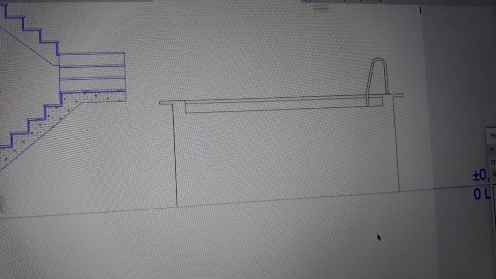

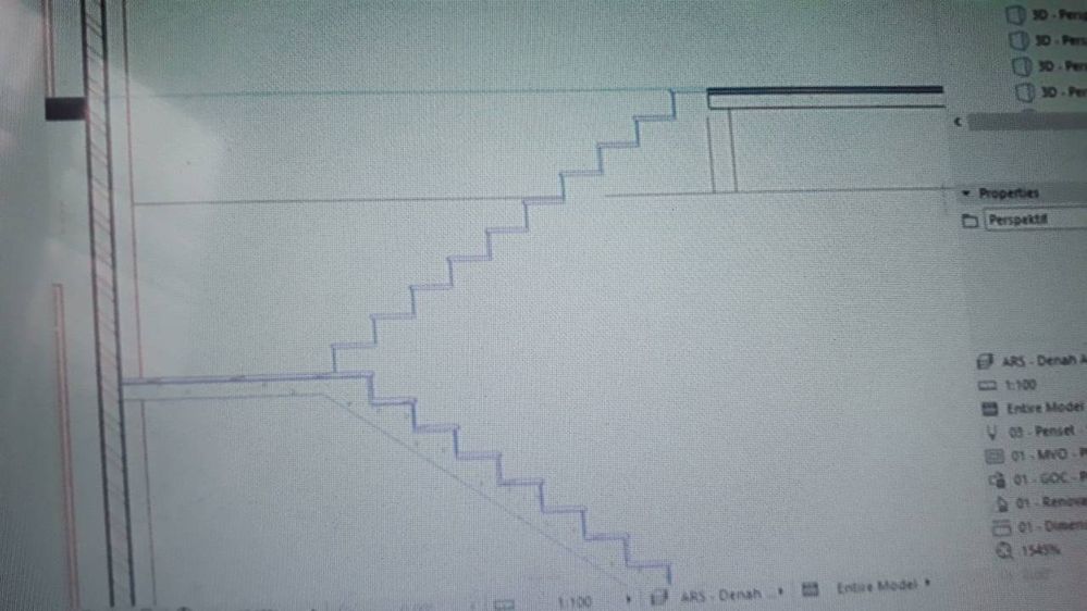

When i do a section for stairs and some object like swimming pool, some lines which should technically be there in section drawing are missing (which if i select the stairs it still recognize and exist, but if we don't select the stairs, some line just don't appear/ the outline don't show) which makes your technical drawing wrong. I really don't know why and how to fix this up...

this is actually what happened on my case...
marcel

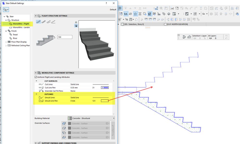

Thanks for the picture.
I can replicate this if I set my flight outline pen colour to the same colour as my background.
If that is not it then I am not able to replicate this problem and don't have any other suggestion other than those mentioned in the other post.

But for some archicad object like this swimming pool, i've tried the same method but still couldn't find a solution. Could you also try this out...
marcel
Check the pen colours set in the object settings.
Also check if you have chosen to override the object pen colours then you need to check the cut and uncut pen colours.
Actually this is one reason that I don't use a white background in Archicad.
I have a pale green (just like the old drawing boards - makes me feel nostalgic )
I don't have any pens similar to this green so I can see everything no matter what pen is used.
I still know that white pens will not print (i.e. will print white) and I can see exactly where I have used them.
