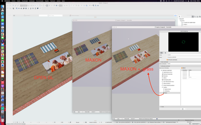

NON square images [grass effect ]
hello !
why can't I make any NON square 3D grass using an IMAGE... !?
please see the video.
https://www.dropbox.com/s/fqme8po7si3a77b/TAPETE%20RENDER.mp4?dl=0
tnks

what are the geometries made of? thin slabs or picture frame object?
it could be caused due to the difference in material settings - basic engine is what you see on your viewport and cinerender settings are what you see in the rendered image. these two are not synced, so if you change something in one, you have to manually change in the other as well.

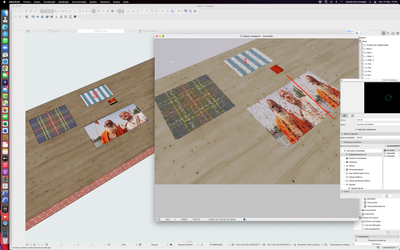

Claudio Lima
Hi Emre !
thin slabs
the error its only in GRASS mode, the material is the same in internal and maxon engine.
look this image.
