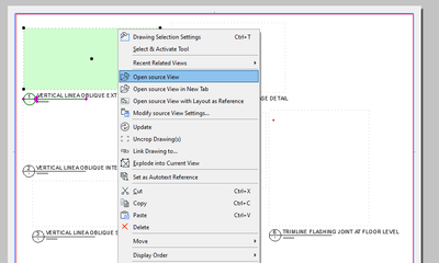

Need help, All my drawings become blank in my layoutbook?
Jeffrey WU
All my details in my layout book become blank after its auto-update, but when I "open-source view",
 I still can see them in view map and worksheet.
The only thing I changed is that I copied another detail from another Cad project to my worksheets.
Many thanks.

Gerry Leonor
they might be cropped out of the drawing view.
temporarily, change one of the drawings from "Manually resized frame" to "Fit Frame to Drawing".
if the drawing jumps Fitted drawing moves away from where it is in the layout, that'll mean the Saved View is in a different location. that's why the Drawing is showing as empty in the layouts.

Thanks for your help.
I tried "Fit Frame to Drawing" and the drawings jump to another place but I am sure I didn't do anything with my worksheet except copy-paste a detail.
I can not repair it at all even if I delate this details.
And I did a test that I copied the same detail to a new project's worksheet and all details become blank again. I have no idea why it happend.
Thanks anyway.

You have an exclamation mark on your view tab. Check and update your saved view settings. I assume the copied detail messed up some layers and their visibility settings.

When this happens, the best solution would be to start again and let the layout's drawings to be updated manually.
