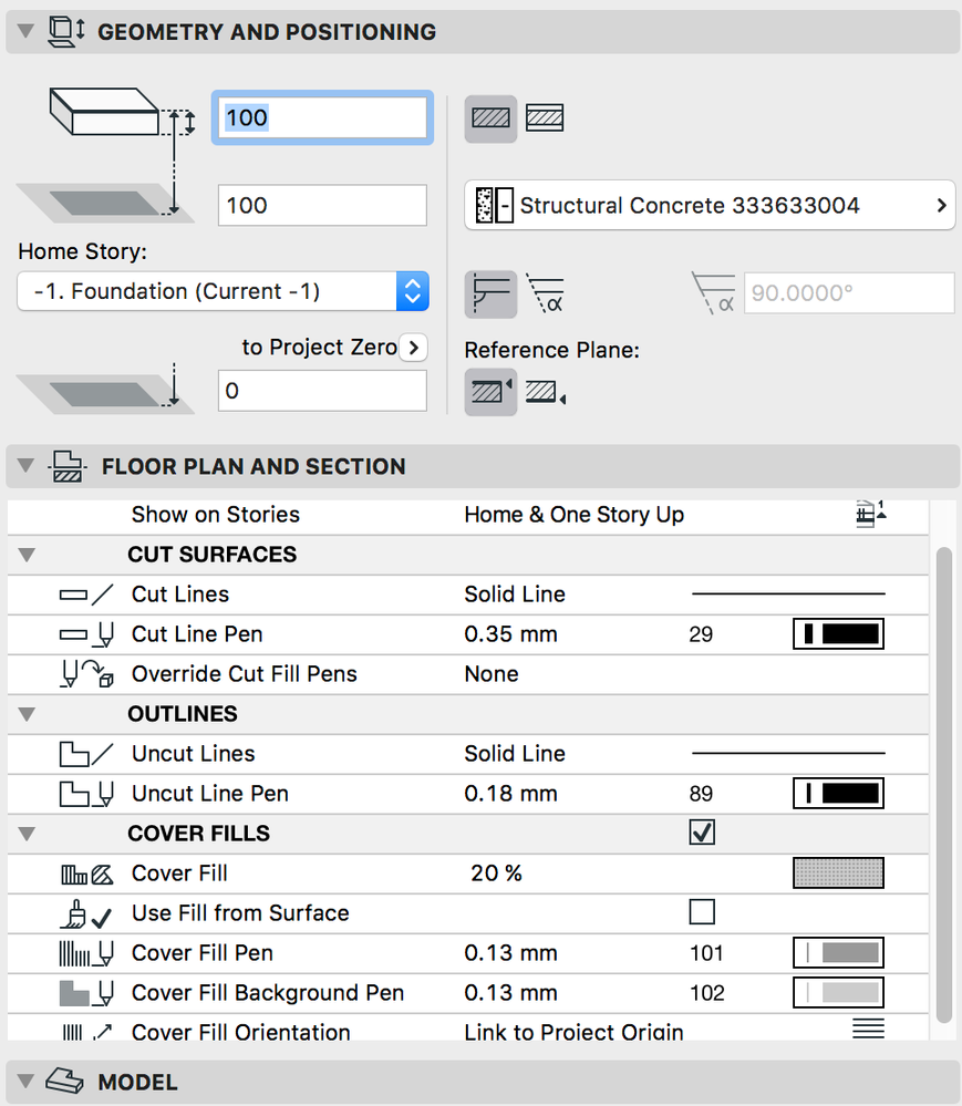

laz89 wrote:GO Combinations are just an assembly of individual rules.
Hey I'm still having trouble figuring out what settings i actually need to change. I have changed the drafting graphic override combination to have all the cover fills not show up (unticked all the boxes - is this what I am supposed to do?) the slab I am wanting have overriden the cover fill is still showing - nothing i seem to change in the graphic override settings seems to change the display on the plan. Can someone please explain how I actually go about this?

laz89 wrote:I would play around with the various options and make friends with GOs. They are going to be in your life for a long time, now.
Ok thankyou- I was thinking that leaving them unticked would make them override - oops. So it seems that you need all 3 (all cover fills, solid background, solid foreground and transparent) all set to the same overrides? or is it just one? I have it working now.
