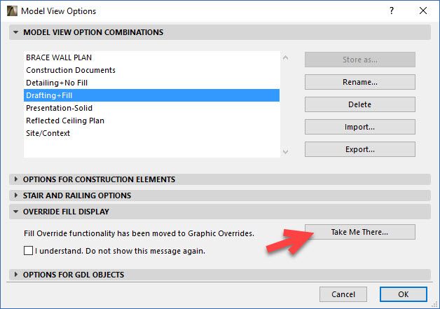

Archicad seems to have changed the location of overriding cover fills in the model view options to having it in the graphic override combinations. Before I used to just go into the Model View Options to change the cover fill settings - now it seems really complicated and I'm not sure what I'm supposed to click in order to not show a cover fill on a model view combination. Help!

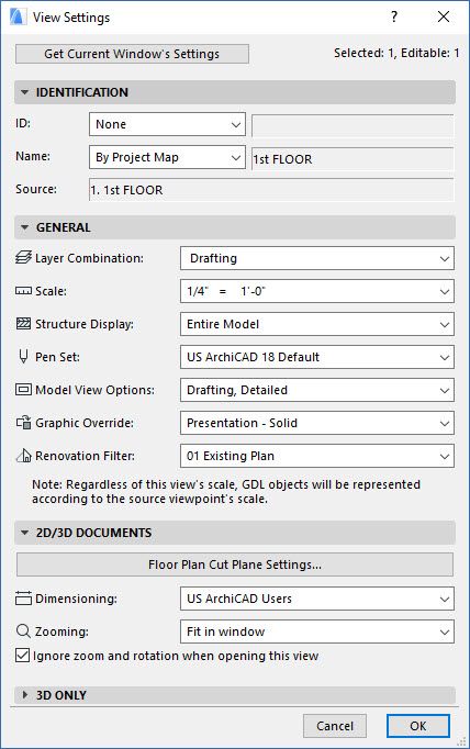

Hi there, thanks for the reply. I know how to get to the graphic overrides menu settings, but not sure what to change.
I have a slab that I want to show on both the floor plan and the site plan. On the site plan i have a cover fill, but do not want the cover fill to show on the floor plan.
Steve Jepson
Make a different View for Site Plan and the Floor Plan. Each View can have it's own settings.
Hey, again, thank you - but maybe I'm not being very clear. I am aware that you can have graphic override combinations for different plans such as site and drafting. My question is I'm not sure what to change in the graphic override settings in order to not have the cover fills show. At the moment under drafting - i have unticked the boxes for "all cover fills" yet it still shows up. What settings do i need to change??
