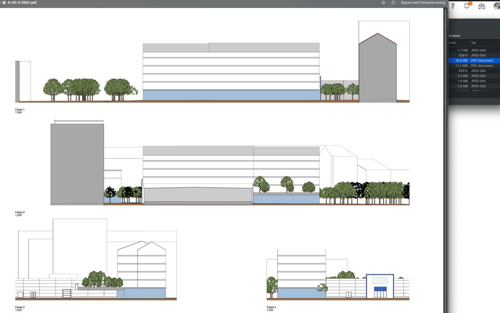

Hi I'm using new function on facades drawings  - Surface Textures And Soft Shadows.
It's very nice but when I opening this file is take ages after export and when I sent it to customer he cannot open. ( attached in link )
How can I optimise and keep nice looking ?
For example I turn off trees but I don't get it why I have to sacrifice them.
I know I can use other trees just for section but is't quite annoying.

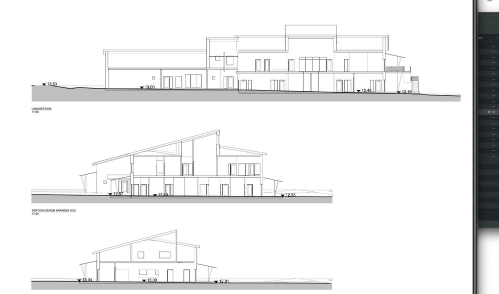

Why this drawings have just 61 kb and my section have 16 MB  ? without tree still 4,6 MBSkärmavbild 2022-02-17 kl. 10.46.51.jpg

Im not on 25 as of yet, however I had ran into similair isuues when exporting axonometric drawing from older versions of Archicad. The problem for me was that Archicad orients the vector hatches for each individual surface. This results in more vectors than adobe acrobat could handle. I suspect it does something similair when aplying the shadow to your highly polygonal trees. To counter this I would either use a bitmap "billboard style" tree from the library - you can easily replace the current ones and maintain the simbol in 2d or add 2d foiliage to your cuts and turn of the trees in sections / exterior views. 3D trees look ugly in sections anyway.

Thanks for good advice I can fix the trees i guess with other trees just want know If I have to have two types of tree for it.

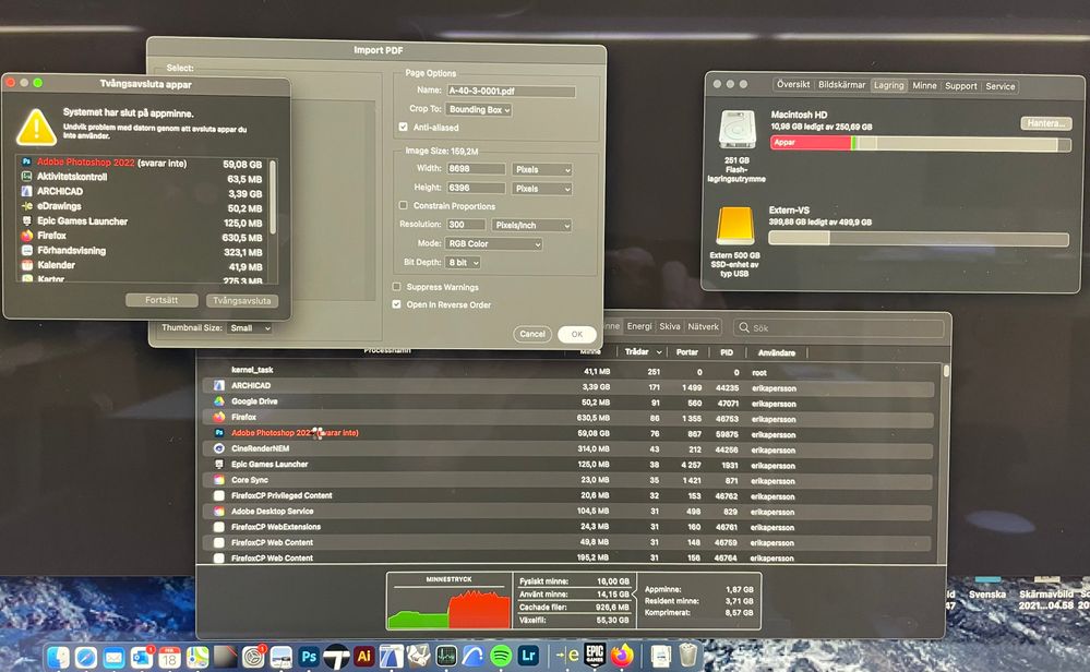

If the problem is what I pinpointed - e.g. lots of vectors to be calculated by acrobat, then I fear there is a little that can be done to help it. However, when looking at the images atached it seems as a rather simple scene. One thing that could work, is to open the PDF in photoshop,if you have access to it and rasterize it to high DPI. For me PS always took its sweet time but ultimately succeded in producing the desired Jpeg. I can however understand why that might not work for you.

BTW: Opening in PS was such bad idea 😅 I tried it to open and it crash it because it need more than 60GB just for opening 16 mb PDF 🤦‍
