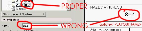

PM9 isn´t posible use autotext <LAYOUTNAME> in other l
May somebody help me... By entering text in field "layout name" its writing only EN characters, although I have other (CZECH) keyboard active. Thanks

Váš problém je způsoben pravděpodobně použitím INT verze.
V případě použivání české verze se tento problem nevyskytuje.
Djordje
If my non-existand Czech is good ...
The problem is in INT version; the CZ version would work correctly.
Djordje

set registry value 'Font Script Code' to 238 under regitry keys:
HKEY_CURRENT_USER\Software\Graphisoft\ArchiCAD\ArchiCAD 9.0.0 INT R1\Font Description
and
HKEY_CURRENT_USER\Software\Graphisoft\PlotMaker\PlotMaker 9.0.0 INT R1\Font Description
Gergely Kmethy
VP, Customer Success, Graphisoft
Thank you... good tip..
