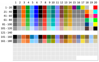

The first eight Pen sets (01 - 08) have 255 Pens which are arranged in 20 columns and 14 rows. The first 180 Pens have defined values in all default Pen sets, while Pens 180-255 are kept for further user functions. The last three Pen sets (09 - 11) have 255 Pens with pre-defined values.

Columns in the Pen Table
To make it easy to distinguish among Pens and their functions, the Pen table’s columns are divided by color group; each group is assigned a general element function; and within each group, each Pen is assigned a more specific function.
For example, the third column of the „Architectural” Pen Set is the „Openings” group, consisting of 6 Pens, each a different shade of orange, and each assigned a specific function such as „Openings: Cut-Structural” or „Openings: Uncut-Overhead.” Generally each function corresponds to an Archicad Tool, whose default settings are configured to use these assigned Pens. However, some columns are dedicated to functions that cannot be assigned to a certain tool or element type.

Rows in the Pen Table
While the Pen’s column determines the element’s function (e.g. Pens in Column 3 are applied to elements that function as an „Opening”), the Pen’s row determines its attribute (e.g. Pens in Row 6 are used for „Symbol and Separator” elements). Pens that generally have thicker lineweight are set to brighter (higher saturated) colors.
In any given column, Pens are listed in descending order of their saturation value and line weight. The first row is an exception: each Pen is assigned the most frequently used lineweight using an easily distinguishable color. To remain compatible with patterns of use from older ARCHICAD versions (up to ARCHICAD 9), the first row’s Pen weights and colors are set to allow full functionality even if using only the first 7 Pens.
Index numbers from 1 to 180:

The default Pen settings for Archicad construction elements and library parts are configured to use the relevant Pens according to the logic presented here. However, please note that the Pen sorting method summarized here is only a suggestion, and the user can reconfigure the Pen table based on a different preferred logic or office standards.
The „Description” field of the Pen table contains descriptive information about the Pen usage, which is fully editable by the user. This description, in turn, is visible in the Settings dialogs where the user assigns Pens to elements, making it easier to select the right Pen.
Since the Pens are arranged within the Pen set according to function/thickness, the user can easily navigate within the Pen table and select the Pen or Pen set corresponding to his/her current needs.
